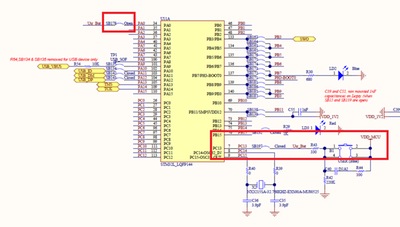

According to the shematics of NUCLEO-L4R5ZI-P, PA0 is not connected to the user button (SB179 is open) therefore there is no pull Up/Down resistor. So PA0 is floating and the level at its input is undefined.
Knowing that you didn't set any pull Up/Down on PA0, the status will be not defined:
GPIO_InitStruct.Pin = GPIO_PIN_0;
GPIO_InitStruct.Mode = GPIO_MODE_INPUT;
So use PC13 instead as the button is connected by defaut to this pin or use PA0 from the board connector but you need to set a pull up or down resistor.
Hope it does answer your question

The user button is on PC13. If you want to use PA0, you'll have to unsolder the solder bridge SB197 and solder SB178.
Otherwise, read PC13 instead.

PC13 works :grinning_face_with_sweat:. I should probably get intimate with the schematic. Thanks.
