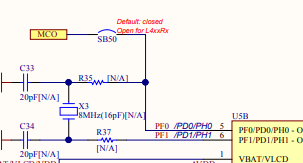

1. on your board the clk comes from st-link, not a crystal. so set to this. the input might (i dont know) be different, in switching level etc. , when set to crystal.

1. there is no hse crystal...see circuit of board. (btw which board you have ? i looked at -C04 )
+ 32kHz is lse crystal, should be there.

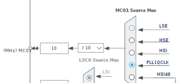

3. set mco output "on" . then in clock tree choose, what there should be : master clk or whatever you like to see and is possible (on this chip).
this you "see" on a scope then, on mco pin. thats all.
i do this on a new board always - just to be sure, it works as i want. then disable and use pin for something else ...or let it run , as you like.
from H563: (more complex)
