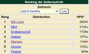

its not ubuntu...its MX. see ranking...and ubuntu..
https://distrowatch.com/table.php?distribution=mx
