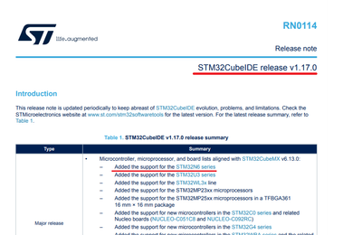

@hamzdmr wrote:
I am currently using version 1.16.1,
1.16.1 does not support STM32N6 products. It was added in the V1.17.0:
From the release notes:
Hope that answers your question.

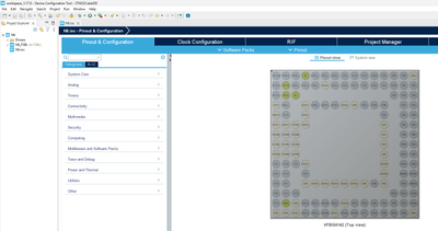

With STM32CubeIDE 1.17.0, I cannot see that issue. Are you sure you are using that version?

2025-02-17 4:51 AM
