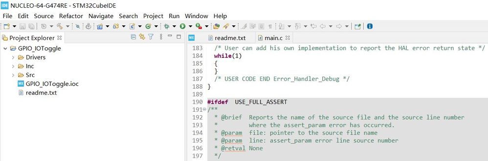

I used this: File --> New --> STM32 Project --> example selector in STM32CubeIDE, the project could be saw in IDE:

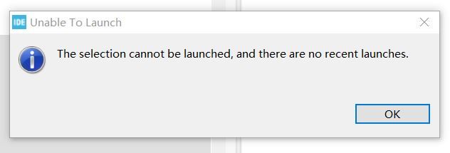

but the build icon was unable, when I clicked "run", it was prompted:

Something wrong here.

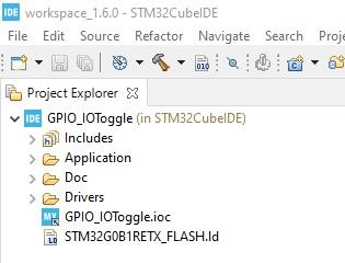

You're not getting hammer because your so called project is not one. You don't have STM32CubeIDE icon decoration if GPIO_IOToggle folder.
Means Eclipse metadat are lacking here ... so no chance to get any toolchain setup or ...
Second your so calle dproject doesn't have any linker script file ... weird too ...
Here is expected example import result:
