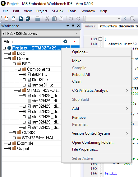

Could you please provide me which IDE are you using?
if you are using EWAR ( IAR), the stpes below helps you to add USE_STM32F429I_DISCOVERY_REVD" define in the toolchain's pre-processor options:

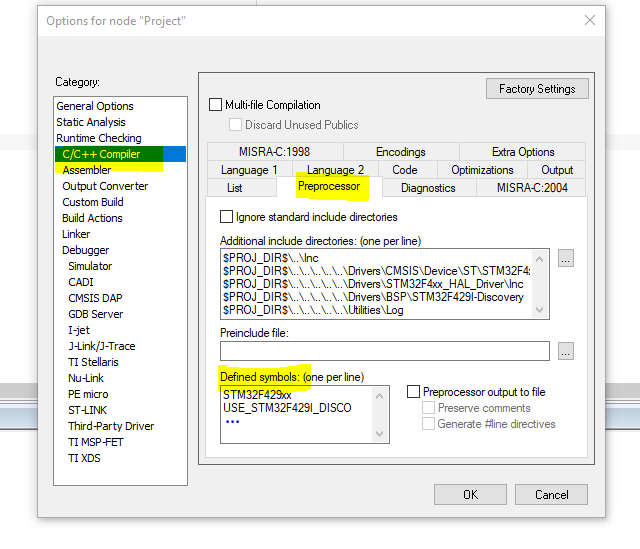

1/ click right button on your project as screenshot below 2/ choose c/c++ Compiler , Then click on the Preprocessor : in the block
defined symbols add your define
