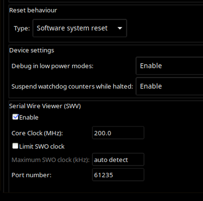

i got quite some difficulties, having this run in a reliable way on a NUCLEO G431KBT6.
It more often does not work, as it would work. It often just wouldnt print anything (But it had before, without issues!). Sometimes the swv debugger couldnt be enabled on debugger start, or the arm-none-eabi*.exe crashed. (i did not made a screenshot - foolish me).
Anyone has some experience with this and could give me some tipps?

just from your shown settings: you have to enable SWV (and set: real core clock ) to use it...
2024-10-27 2:57 AM
I have. I accidently switched the configuration. I have reuploaded it.

The clock gearing of core vs debug needs to be synchronous. Watch ST-LINK/V3 not having MCO clock correct, depending on implementation/settings 8 MHz vs 8.333 MHz. SWO baud rate should be reasonably tolerant, but SWCLK going a lot faster on V3's, buffering of SWO/SWV perhaps an issue.
Perhaps buffer and use a slack UART for diagnostics. Or be able to switch into diagnostic vs normal mode via NUCLEO VCP.
SWCLK = USART2_TX
