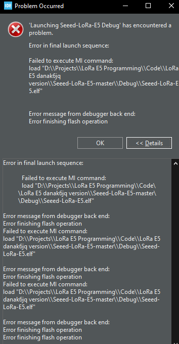

Recurring Error Message in STM32CubeIDE When Running or Debugging a Project. It shows-
'Launching pain Debug' Has encountered a problem.
Error in final launch sequence:
Failed to execute MI command: load
C:\\Users\\USER\\STM32CubelDE\\workspace_1.12.1\\pain\\ Debug\\pain.elf
Error message from debugger back end:
Error finishing flash operation.
and also it showing
"Error in final launch sequence:
load C:\\Users\\USER\\STM32CubeIDE\\workspace_1.12.1\\try\\Debug\\try.elf
Error finishing flash operation"
How to solve this problem? We are using STM32 NUCLEO-F446RE Board

Hi, I've got the same issue. Here's the error log that appears in the failure message:
load C:\\TouchGFXProjects\\MyApplication\\STM32CubeIDE\\Debug\\STM32U5A9J-DK.elf
