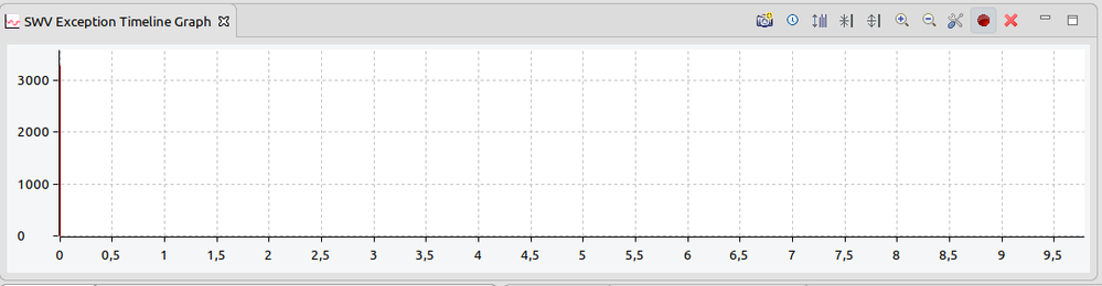

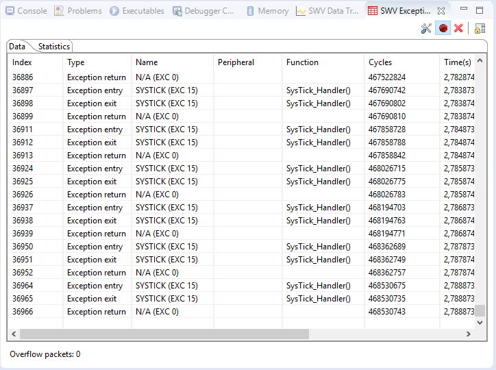

I created a simple project in CubeIde to try out this function.

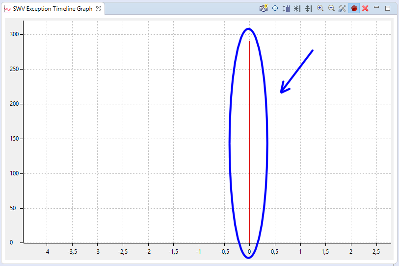

SWV Exception trace log works as it, but the timeline graph seems to me wrong.
Belong the debug session a moving vertical red line appears on the graph, and nothing else.
Could anyone help me?

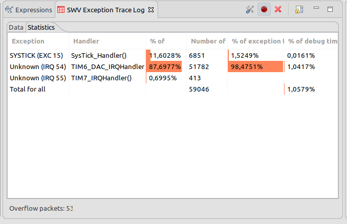

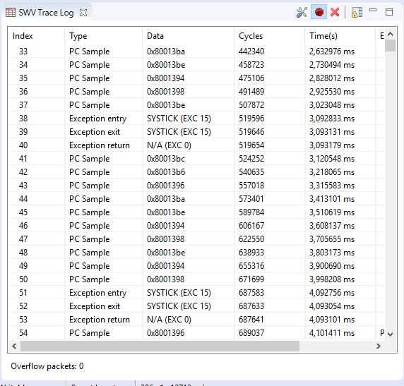

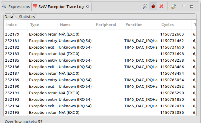

Since I can't accept not being able to use this feature, I did some additional tests.
Here are some screenshot from the debug session of test project.
You can see that there is no packet overflow or other issues during the trace.
The graph is totally useless. When I pause the debug session, I cannot scroll the trace log because eclipse refreshes it periodically.
