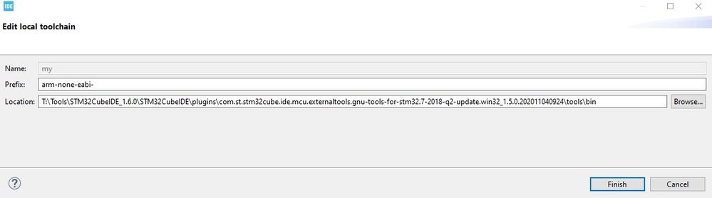

  • Open  Toolchain Manager (it will take its time .... patience....) then select "Add Local".
  • Then browse to the toolchain before update to 1.6.0 , usually it is "7-2018". Go to the bin subdirectory under it and select that.
  • Give it any name, for example "Old toolchain".
Then it will be available in Toolchain manager and you can select it for the debugger. The the debugger should work.

First: why do you add a local toolchain ? sounds the one you'trying to install as local is already part of installed toolchain according toolchain manager status
Second: if aiming anyway to point by yourself to a local toolchain I guess "features" path is not ok ... let's try "plugins" instead ... you have to provide path to repository where toolchain binaries are

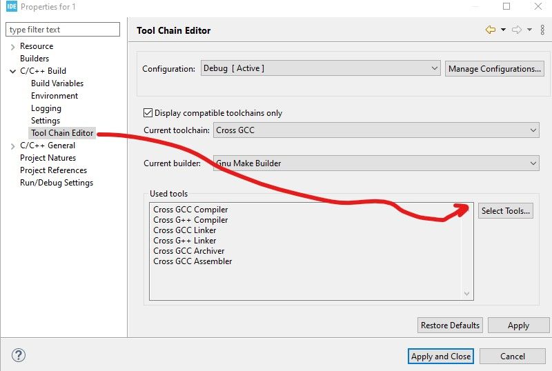

My advice is still to rely on first :) ... then look at project properties to point to expected toolchain:
i don't actually have that option, what should i do?
According latest sharing your project is not a STM32CubeIDE and not a project relying on any STM32 toolchain so ... no chance to get option here ...
Sounds you have created a common C/C++ project but not a STM32 one. Is such on purpose ?
You can do if on purpose but be aware you're out of STM supported path. STM32CubeIDE support common C/C++ project (Eclipse + CDT basis ... no STM here) but be aware you've to be a bit more skilled then ...
If moving this way let's try to play with

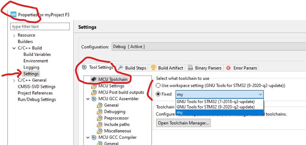

Yes this is what I mean. Yes this is what I mean. You have 9-2020 so it may be caused by update to 1.6.0. But the other toolchain should be ARM, not MINGW. It is located under CubeIDE plugins directory, at same level with 9-2020.
-- pa
Because (al least in my case) the "old" toolchain is present on the disk, it's just the toolchain manager thinks it is not installed.
My theory (maybe wrong) is that the GDB or OpenOCD server "locks" to the toolchain that it gets at the first installation time, and it survives updates.
