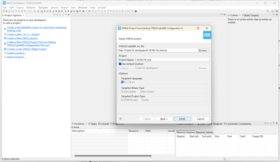

I'm trying to create a new project from a exiting ioc file.
When I click the "finish" button, it shows a progress bar but disappear very fast, and it did nothing else. No new project created, no nothing. I don't know what went wrong. Is there an error log or something so that I can see what's happening?

2025-02-16 11:06 PM
Restart pc solved the problem.
Should add a prompt in the installation process to tell people restart their machine after the installation.
