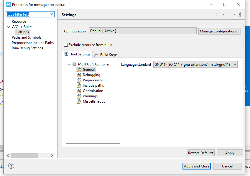

Hi. I have the following code:

C:/Users/User/STM32CubeIDE/workspace_1.6.0/usbtest/Debug/../Core/Src/messageprocesser.c:56: undefined reference to `strncpy_s'My understanding of strncpy_s is that it is a part of C11, and it is part of the string.h header file. I am unsure why my compiler does not consider strncpy_s as a valid preexisting operator.
My compiler is GNU11, so it should include C11 based on my understanding.
Please let me know if more information is required.
