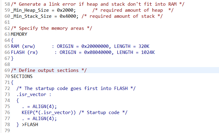

I am working with the stm32f413VGT (100 pin) controller on a custom hardware.
The project I am working on will be start by the bootloader. The bootloader is flashed at address 0x8000000.
My project should start from FLASH address 0x08040000 and I have changed the address in the linker file.
The project worked fine with the default FLASH address 0x08000000 (without the bootloader), but it did not work after changes in linker file.
I have tried debugging the problem and the code is getting struck on HAL_delay() function. If I remove the delay then it is getting stuck on the first printf() function it reached.
Do I need to do something else to change the start address?

2023-02-03 1:21 AM
Thanks for the reply.
Yes, I didn't do any changes with SCB->VTOR.
I have made the changes in the system_stm32f4xx.c file (changed the SCB->VTOR to 0x08040000) and now the program runs as expected if flashed directly from the IDE.
But is still not able to boot from the bootloader.
the bootloader is downloading the .bin file and writing it to the flash from address 0x08040000.
And using the below code to start the application ->
