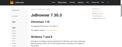

The minimal required version for the integrated JxBrowser is Windows 10 or Windows Server 2016.
Jxbrowser does not support windows 7 since 21/02/2023.

If I correctly understand: ST uses JxBrowser (commercial) library for having full support for HTML+CSS+JavaScript application in Java. myST support and acompaning functionality is written in JavaScript and web pages. Unfortunatelly JxBrowser requires Windows 10 at least.
It is a pitty that ST did not use Java for the application.
