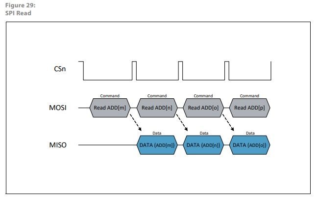

Which part, the one where the document explains you're sending data out, and getting it back later?
That each 16-bit frame has a CS around it, the bus is symmetrical, so you send the read command in one burst, but get the response in the next, and send a new command or NOP.
So Read ADD[ANGLEUNC] then Read ADD[NOP], the data you get back when clocking out the NOP will be the ANGLEUNC value.

>>HAL_SPI_TransmitReceive(&hspi1, (uint8_t*)&angle_addr, data, 16, HAL_MAX_DELAY);
16 bytes? Also doesn't it return the response in a subsequent interaction? It's not going to know the address whilst you're shifting it in. That's what the NOP's for, to clear out the chain of requests.

Send a READ ANGLEUNC + NOP sequence as a 4-byte pattern
uint16_t value = ((data[2]<<8) | data[3]) & 0x3FFF;
float angle = (float)value*0.02197f;

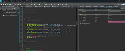

2024-09-01 8:32 AM - edited 2024-09-01 9:34 AM
sorry i couldn't understand your second statement ERbits you mean the don't care bit rights yeah i changed it afterwards to remove the first two bits
You mean like this
while (1)
/* USER CODE END WHILE */
/* USER CODE BEGIN 3 */
HAL_GPIO_WritePin(GPIOA, GPIO_PIN_4, GPIO_PIN_RESET);
HAL_SPI_Transmit(&hspi1, (uint8_t*)&ANGLECOM, 16, HAL_MAX_DELAY);
HAL_GPIO_WritePin(GPIOA, GPIO_PIN_4, GPIO_PIN_SET);
HAL_SPI_TransmitReceive(&hspi1, (uint8_t*)&NOP, data, 16, HAL_MAX_DELAY);
uint16_t value = ((data[0]<<8) | data[1]) & 0x3FFF;
HAL_Delay(250);
2024-09-01 8:59 AM

is my code in the above reply is correct?
2024-09-01 9:34 AM
I tried this and i get a value in the range of 0 to 360 degree but the live expressions doesn't seem to be updating
