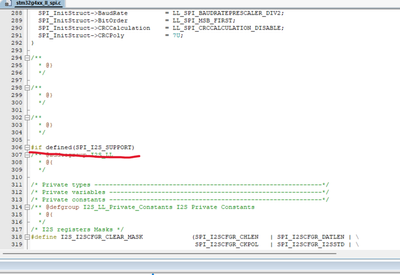

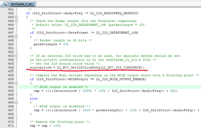

When I configure the LL libraries for SPI on the STM32G474 in CubeMX, an error occurs in the stm32g4xx_ll_spi.c file, as shown below:
The issue is traced to the following:

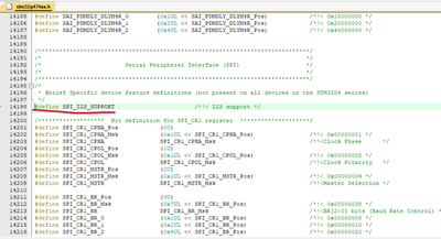

I did not enable any I2S-related features, but the file generates I2S-related functions. This is primarily because an I2S macro definition is generated, as follows:
This macro definition is automatically generated in the stm32g474xx.h file, as shown below:
I need to comment out this macro definition for the entire project to compile and run properly.

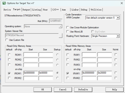

What is the compilator you are using?
Best Regards.
STTwo-32
2025-09-15 3:30 AM
I am using ARM Compiler 5.
