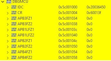

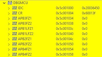

My debug registers look like this:
CM4:CM7:
These should be OK, right? The clocks should be running as normal.
I have now had the calibration running in the background for couple of more minutes, and it is still running, without hitting any timeouts or anything.
