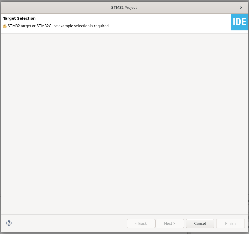

Sorry, I cropped the screenshot to just show the message.
This is the sequence of events after File > New > STM32 Project:
First it appears to be doing something ...
Then the Target Selection windows opens, empty ...
I have checked out Installation to Project instructions and walk-through videos and they all show this last window fully populated.

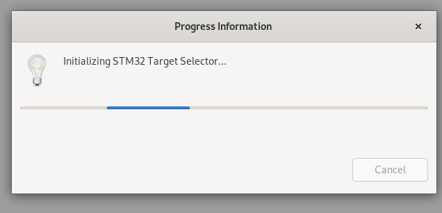

If I select Help > Check for Target Selector Device Database Updates,
I get this:
Which just sits there until I get bored and close it.
