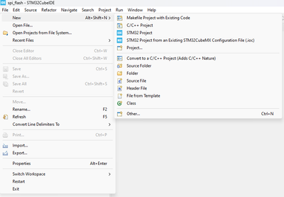

I'm trying to setup STM32CudeIDE 1.17.0 to build and debug my Zephyr OS project (STM32H745). Mainly to get access to the dual core debugging features that the IDE provides.
I found Zephyr has a page to guide setup on a Linux machine, but the same menu options don't appear in the Windows version?
There is no option for STM32 CMake Project?
The other thing that would work was if I could just debug by pointing to pre-built .elf files. Can this be setup?
STM32CubeIDE now supports CMAKE (with newer versions), try starting from STM32CubeMX and generating a CMAKE file.
Also, note that STM32CubeMX- generated code cannot be used if you intend to use Zephyr drivers because the zephyr configuration is done using device tree.
2025-04-28 9:35 AM
