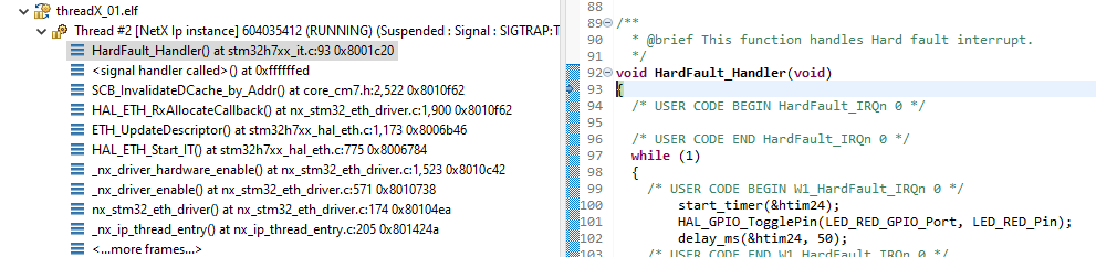

When using the debugger it becomes visible on the left side, that the NetX Ip instance tries to invalidate the DCache, but this of course makes it go haywire:
This lead me to the idea if I can either prevent the ADC / FFT buffers from being cached, or better: Invalidate the cache as they do for NetX, which should lead to the cache being re-filled again, right?

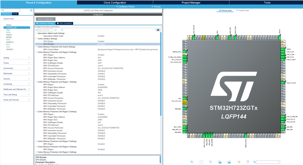

Based on this idea I made a screenshot of the M7 cfg, including the MPU, which was set according to the Ethernet / NetX tutorials:
Hope I provided all information necessary, otherwise please ask :)

i dont use MPU - i dont know how.... so i have MPU off.
but should be possible, to define the buffer in MPU as "no cache access" area, then need no invalidate.

> it runs into the HardFault handler.
From your call stack, the fault is caused by SCB_InvalidateDCache... when the D cache is not enabled.
It is not clear whether this is a bug in the CMSIS version included by ST in the STM32H7 library, or the D cache management should never be called when D cache is not enabled.
My workaround is to NOT to call D cache management if D cache is not enabled.
