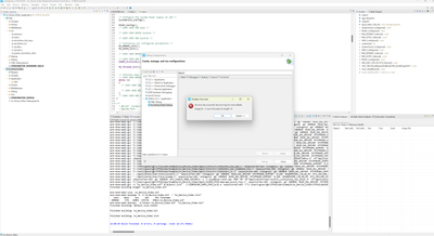

Hello @saib
Have you experienced an error popup similar to this?
THX
Ghofrane
Hello @Ghofrane GSOURI
Yes , Exactly same error , i have observed.
