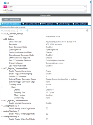

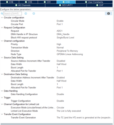

Attached is how I have configured the ADC + DMA:
