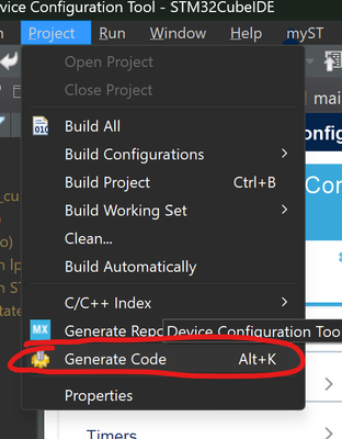

Code must be generated after you configure the IOC file. To generate code, go to Project -> Generate Code

Okay so MacOS.
Not sure how the screenshot helps here. Did you try the project menu? Show it
> it says that the code is being generated
Perhaps you need to log in or download the relevant software packages in Help -> Manage Embedded...
2025-02-24 6:45 AM
Ok, I downloaded the software packages. Now it works. Thank you for your help
