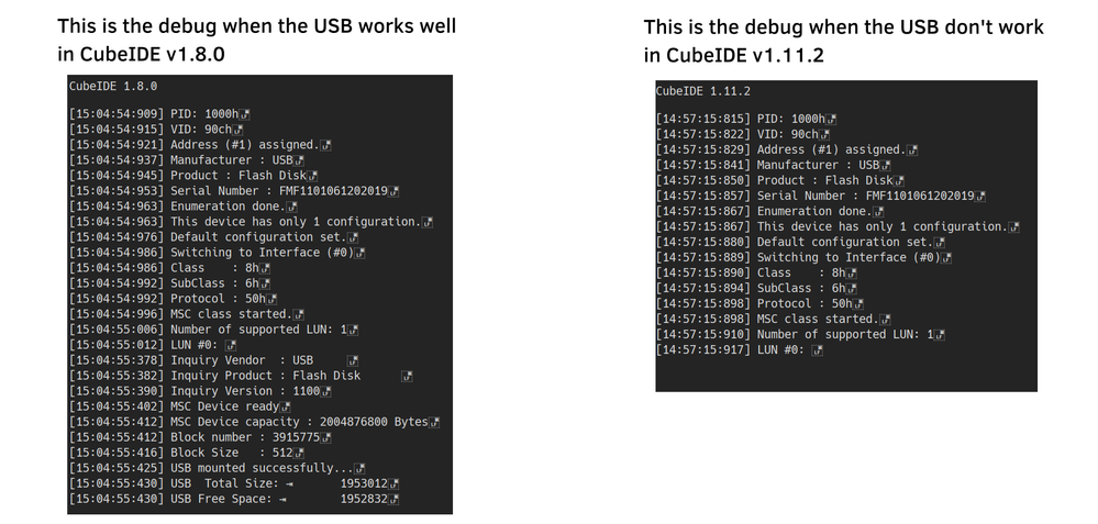

2023-02-25 5:23 AM
I turned on the debag for the USB to compare in the working version in CubeIDE v1.8.0 with a non -working CubeIDE v1.11.2
Could someone tell me how to fix initialisation of USB?
