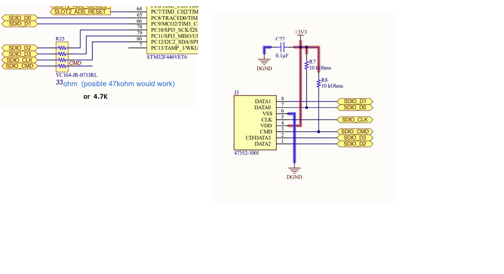

Hi, I have an issue with the SD card on a STM32 F446VET.
if(f_mount(&SDFatFS, (TCHAR const*)SDPath, 0) != FR_OK)
Error_Handler();
else

res=f_mkfs((TCHAR const*)SDPath, FM_ANY, 0, rtext, sizeof(rtext));

f_mount(&SDFatFS, (TCHAR const*)NULL, 0);the error comes at the f_mkfs() that returns FR_NOT_READY Error. Tried the same code on an NUCLEO F446RE and on an STM32F746G-DICSO on both ones it works and it creates and writes the text file.
When connected the logic analyzer to the SD card the Clock is showing fine, the SDIO_CMD and SDIO_D0 no signal at all.

The series resistors should only be 27R or 33R, their role would be to suppress ringing/overshoot. You surely don't want it to act as a divider.
The pull-up on D0,D1,D2,D3,CMD should be of the order of 33K or 47K

2022-07-04 4:00 PM

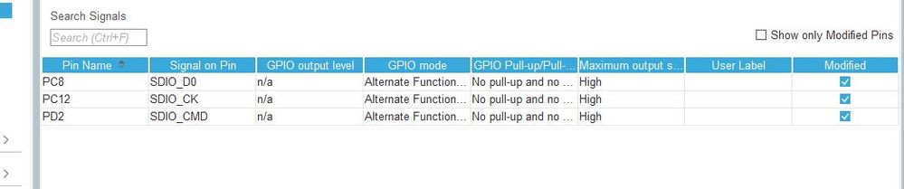

So R7 and R8 should be 47K? Also D1, D2 and D3 don't have any pull-up resistors could I use the Pull-Up option from GPIO settings? and how this settings affects the schematics?
