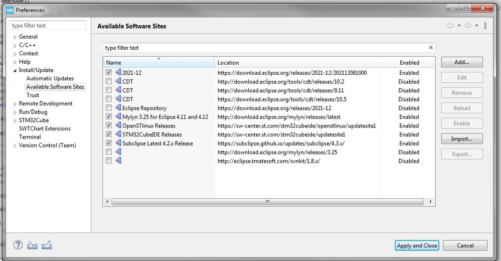

Available Software Sites settings shown below.

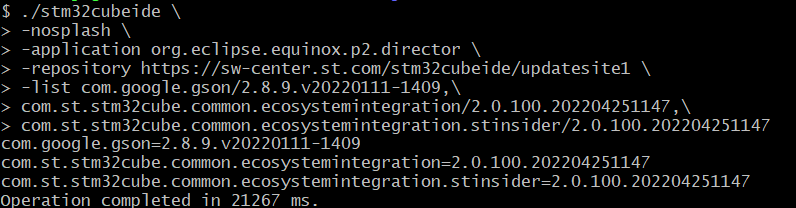

You get this error because STM32CubeIDE can't fetch some plugins (com.google.gson and com.st.stm32cube.common.ecosystemintegration*).
Anyway those plugins are well part of sw-center repository:
You probably had network issues during the fetch, or maybe a corrupted cache in the application.
In Preferences > Install/Update > Available Software Sites, can you press the Reload button on the repository https://sw-center.st.com/stm32cubeide/updatesite1, and try again to update (Help > Check for Updates).
If it fails, stop STM32CubeIDE, delete the following cache folders, and try again to update.
INSTALL_LOC\STM32CubeIDE\p2\org.eclipse.equinox.p2.core\cache
INSTALL_LOC\STM32CubeIDE\p2\org.eclipse.equinox.p2.repository\cache

There are many similar errors for all repositories you have defined in Available Software Sites:
No repository found at https://sw-center.st.com/stm32cubeide/openstlinux/updatesite1
No repository found at https://sw-center.st.com/stm32cubeide/updatesite1
No repository found at https://subclipse.github.io/updates/subclipse/4.3.x/
No repository found at http://download.eclipse.org/mylyn/releases/latest
No repository found at https://download.eclipse.org/releases/2021-12
No repository found at https://download.eclipse.org/releases/2021-12/202112081000
Since it works for another non IT-managed PC on the same network I wonder if your work PC could have custom IT policy and rules preventing those connections... That's said I must admit that it would be strange that the Reload works but not the upgrade...
