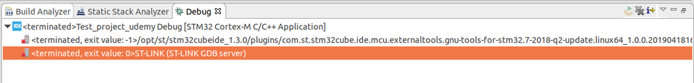

I am using a STM32F446RE and am programming it using STM32Cube IDE. I am running it on Linux 18.04 LTS. It was perfectly working previously and now suddenly dont know what happened, it prompts the following message when I am connecting to the debugger. I didnt mess with the board or the the debugger settings on my PC.
The console prompts the following:
STMicroelectronics ST-LINK GDB server. Version 5.5.0

I also saw these under my debug window. Not really sure what this means.
Could anyone kindly tell me what I could do? Any help would be greatly appreciated!
