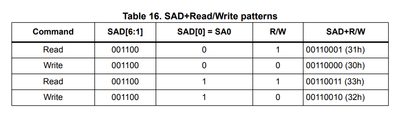

2023-10-18 3:06 AM
Can you please guide me to choose the correct i2c address, Im using LIS3DH sparkfun board SDO PIN is not connected (kept open) only VCC SDA SCL is connected. So i'm currently using (0x18<<1) as an i2c address for HAL_I2C_Mem_Read function.
2023-10-18 3:29 AM
I think you should check this table : ( DS : https://www.st.com/resource/en/datasheet/lis3dh.pdf )
Foued
