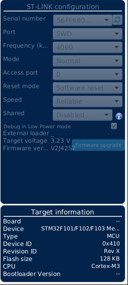

2024-05-01 11:49 PM - edited 2024-05-01 11:49 PM
You're right, I didn't catch that. I was looking at "Board: --".
I finally got it to work. I had my red wire connected to VDD (pin 19 on STLinkV2). I put it on VAPP (pin 1 on STLinkV2) and it worked. But I still have to supply 3V3. But I can just use another wire and go from STLink VDD to STM32 VDD. This way I dont have to use my lab-psu.
Thank you for your help!

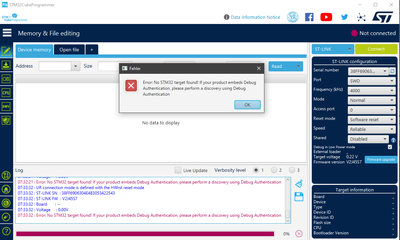

try setting : Reset mode: Software reset , Mode: normal ;
+ show pic, what CubeProgrammer shows.

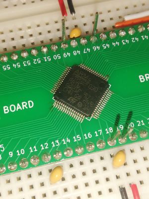

+ If still not working, maybe distance to caps is a bit to much,
can you solder the 100nF cer-caps (SMD) direct on the pin header ? (0805 fits between 0,1" pads)

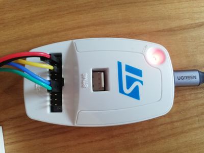

2024-05-01 10:42 PM - edited 2024-05-02 12:17 AM
I am using STLinkV2 i got from mouser. So no clone, I got an original.
Maybe you're right and the capacitors are too far away but I am not the first one to make such a board. Others got it to work: https://youtu.be/ZH7zPy7Jb9M?si=0KXpfGCFPjmd85PN
I don't have any SMD parts. I would need to buy some. And then at this point I would rather design a new board with the capacitors already mounted.
EDIT: While tinkering I accidentally flipped the green and blue wires. This image and the later one where I show the breadboard don't match.
2024-05-01 10:45 PM - edited 2024-05-01 10:46 PM
So : Original STM? You have to connect VDD to the debug probe . + supply 3v3 to target !
(now 0,22V - no power at target cpu !)
2024-05-01 10:53 PM
I have an original STM32, I got from mouser as well.
What do you mean with "You have to connect VDD to the debug probe . + supply 3v3 to target !"
The red wire you see in the image is +3V3 and it's connected to the µC. The µC has 3V2, I checked with my multimeter.
"+ show pic, what CubeProgrammer shows."
If you want to know the target information, I don't get any info. µC is connected but when I click connect it looks like the image above.
2024-05-01 11:03 PM
There is no power ! st-link tells : 0,0 V at target.
YOU have to add VDD 3,3V /gnd to the target cpu ! st-link not giving power, it only checks voltage on VDD.

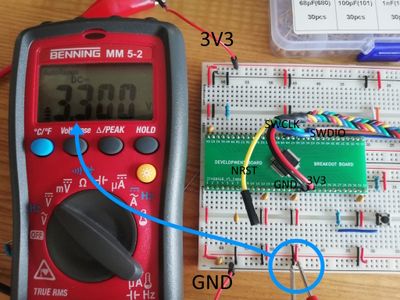

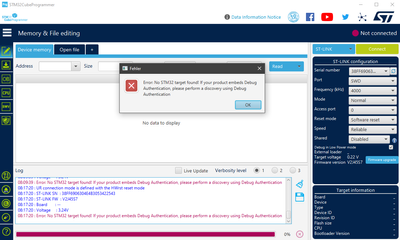

2024-05-01 11:18 PM
Ok, I have now supplied +3V3 to the board with my benchtop psu. Unfortunately CubeProgrammer still shows "now power".
