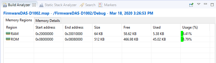

The memory use show me :
So I am a bit confuse why this such behaviour happens!
