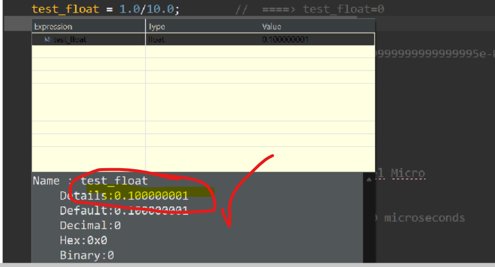

2022-05-26 1:47 PM
2022-05-26 1:47 PM
Hi Tesla DeLorean, thanks a lot for your comment!!!!
You are right, after adding ".0" it´s works.
Thanks!!!! Again
Alfredo
