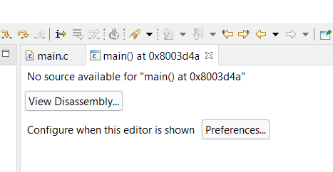

Yes, I pause the code while running that was not reach any error handlers, The code was running properly i am also able to see the led indications also perfectly run as per logic.
While i debug the code i am able to see the below screen. I don't know why that was not hit in inside main().

again, If you're in Release mode, is debug information being created?
2022-05-27 12:53 AM
NO.
2022-05-27 1:49 AM
So the debugger won't know what code addresses correspond to which source lines - as discussed above.
If you want to be able to do source-level debug, then you need to enable the debug info.
