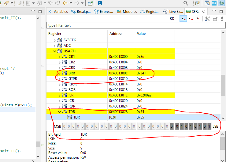

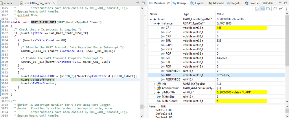

In this interrupt is triggered and call back is hitting, also the TDR register is holding the the proper value, verifies in the SFR for every count of the data to be transmitted. My teraterm settings are below
I'm using STM32CUBE IDE and have not changed any clock configuration. Could any of you help me the reason to find out why the valid data is not reaching the terminal. I have tried the same code with HyperTerminal, in that noting is displayed.
Also verified the USB-UART converter functionality by short the RX and TX of that and ensured there are no issues on the converter.

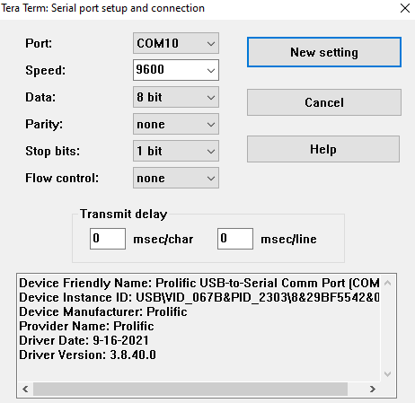

> In this I could see the the transmitted data is received in my tera term terminal, but it is not the one which is transmitted from the code.
What data are you receiving and what do you expect instead?
Seems to be at odds with your previous statement. So TeraTerm receives data but HyperTerminal does not?

Yes, I think there are baud rate issues, I'm attaching the register values seen in the debugger.
Are there any clock configuration to be changed? Kindly guide me.
