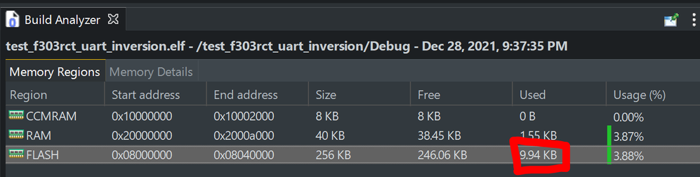

When you successfully build a project, the size is output to the console. This one is 10180 (= 10160 + 20) bytes as the BSS segment doesn't need to be stored in flash.
arm-none-eabi-objcopy -O binary test_f303rct_uart_inversion.elf "test_f303rct_uart_inversion.bin"
text data bss dec hex filename
10160 20 1572 11752 2de8 test_f303rct_uart_inversion.elfIt's also shown in the Build Analyzer:

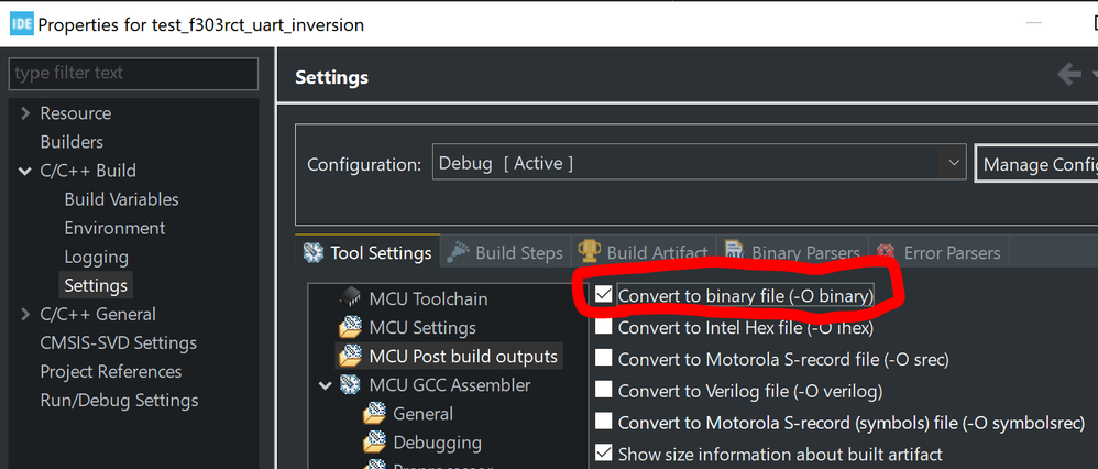

If you want to generate a BIN file, select that option in the project properties:
