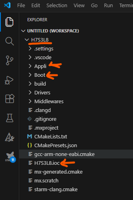

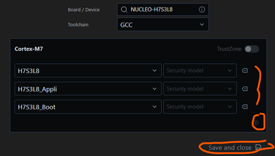

Device detection works for me:
You have then to explicit all projects to get setup completed
Myself I'm adding at once complete MX generated project root folder which is including them all
2025-12-27 8:58 AM
-回到库-
2025-12-29 3:05 AM

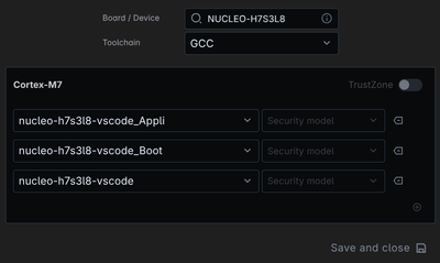

Thanks a lot! I struggled with this issue for hours!
Once i add all 3 project (just to be clear: Boot, Appli and the top level as in your screenshot) things started to work as expected.
Until then i was getting...
Once more simply doing this fixed the issue - no idea why, or why it would not do it by default...
