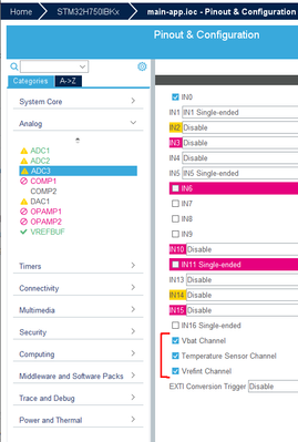

2024-08-16 2:52 PM
If you are wondering about the 3 internal channel checkboxes in CubeMX, they are checked. But it seems the HAL code does not use these to set the corresponding CCR bits...or at least it doesn't seem to set them during the init code before it gets to the main loop.
