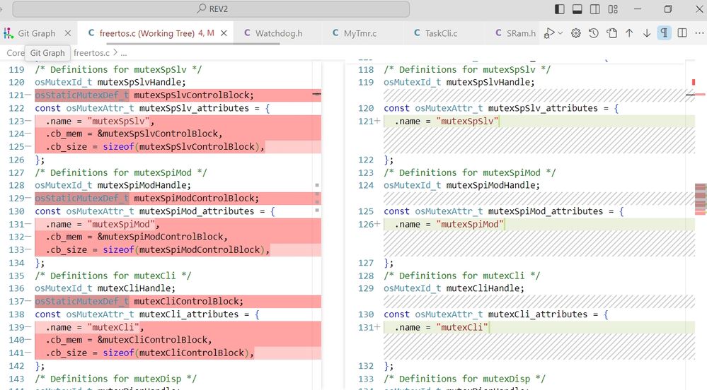

Upgrade from 1.15.1 to 1.17.0. Then open .ioc and renerate code.
I was using static mutex in my code,. But after reneration, the mutexs were changed to Dynamic

Hello @QLiu.6
Thank you for posting!
Is it possible for you to provide your IOC so that we can further investigate the issue?
