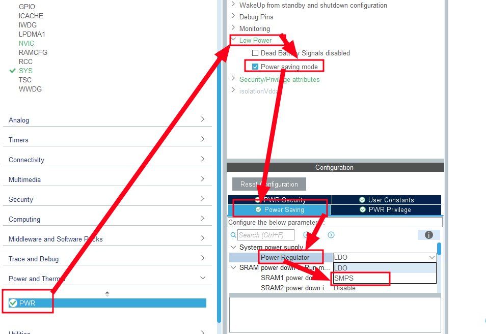

Cube is very enthusiastic about reminding you to enable the SMPS on U5 chips
And it's also infuriatingly coy about how one actually does this:
Here is just the latest example of an understandably confused costumer.
I would like to see the warning message amended to give more specific instructions on how to do this,
(i.e. "enable low-power/power saving mode and then choose SMPS as the power regulator")
and the PWR pane should be modified to be more self-explanatory, either by reworking the options,
or the help strings, or both.
2024-12-01 11:39 PM
Hello @BarryWhit
The warning message on the new version of the STM32CubeMX (V6.13.0) came with the necessary details. For other feedback, you are always welcome to post on the ST Community.
Best Regards.
STTwo-32
