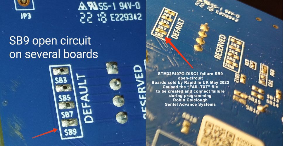

2023-07-26 10:53 AM - edited 2023-07-26 11:24 AM
It is simple, following the last firmware update to the CubeIDE, now when I build our application the first time it lists those 9 errors, if I click build again, it builds without errors, and if I click it again, it lists 9 errors,... and so on.
The STM link error is another issue, on some boards after the first programming
attempt we get the link failure message and the file Fail.txt appears with the message: The interface firmware FAILED to reset/halt the target MCU.
Tried the suggested methods to connect, reset down, BOOT0 to VDD, to no avail.
Read the post about voltage levels, so if it's useful: from the Debug USB connection it gives 2.96V on VDD, and 4.66V on VCC.

UPDATE: The STM link failure that causes the "FILE.TXT" message to be created on the USB Debug folder seems to have been caused not by the IDE update (which causes the intermittent link errors), but by a component fault on the STM32F407G-DISC1 boards. SB9 has a 0 ohm resistor chip, the components look different to its neighbours and is open circuit. Soldering it and closing the link fixes the Link failure.
