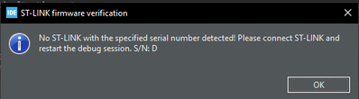

I trying debug a project,bu t when I connect Scan my ST-Link in CubeIDE got wrong S/N and error when start.
In ST-Link Utility gets rigth S/N.

SN "D" shows, IDE found no genuine STM chip on stlink programmer, refuses to work.

Two applications can't have a connection open concurrently.

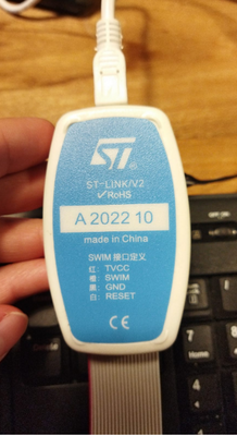

A serial number 'D' seems indicative of a clone / pirate ST-LINK.
ST-LINK Utilities has been deprecated for many years, use STM32 Cube Programmer as a better means of establishing compatibility / usability with STM32 Cube IDE

Probably the "Scan" functionality is not implemented correctly on counterfeit chips. They seem to have serial-number related issues based on the posts that pop up here.

When I debug get this and nothing more

I openned aolne each application, the image i put together just to show.
