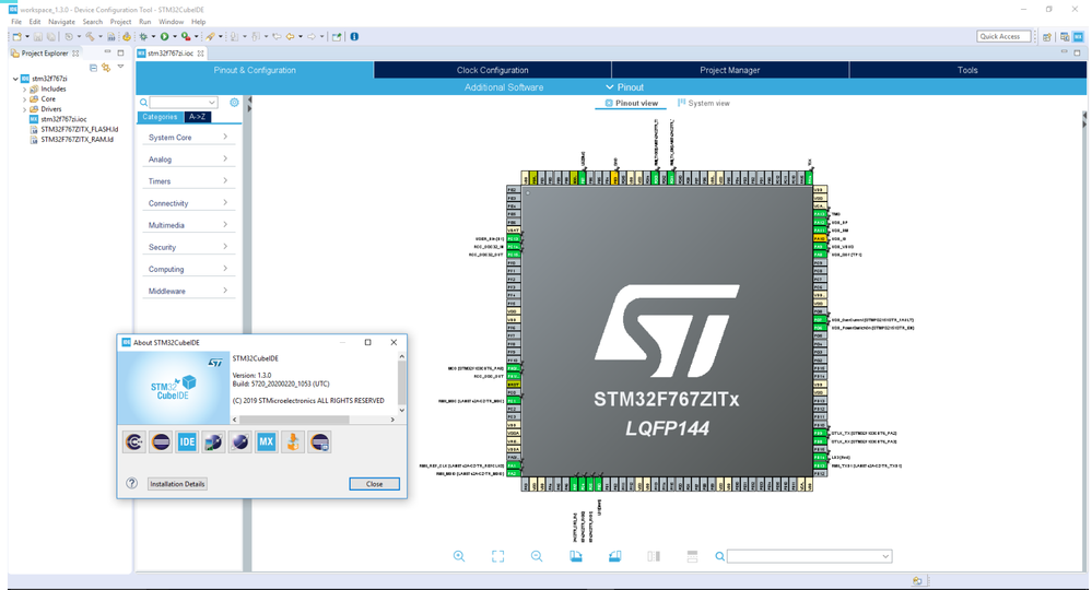

Hi.
This bug presented to me using 1.3.0 either 1.3.1 version of CUBEIDE. I Installed now 1.2.0 version and the problem doesn't appear with the old version.
2020-04-24 2:04 AM
Hi @GMila.1
Using STM32CubeIDE V1.3.0 ,i didn't reproduce the issue.

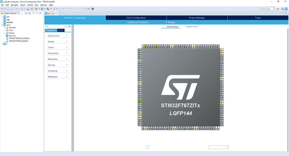

I have a similar issue but the initialization of peripherals to default dialog not appearing for me. So I cant set the pins and they are all grayed out. Can you help me out?
2020-11-19 12:12 AM
I have the same problem with 1.3.0, 1.4.0 and 1.5.0 working under WIN10. Has anyone solved the problem?
