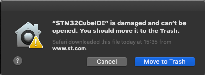

Hello, I'm using Mojave 10.14.6 and have tried both IDE v1.3 and 1.4. The operating system when verifying the app during start up always states:
2020-11-19 7:37 AM
Sorry not an answer but I am getting the same thing on my Mac. I have noticed a few posts like this. Never had a problem on the Windows machines I have used however. Perhaps if one of the ST guys could check this out......?
2020-11-19 8:03 AM
You can try the command given in this answered post to remove the app from quarantine :
