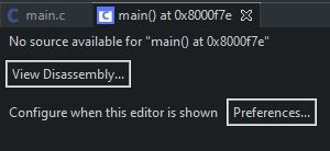

Each project I've migrated from the previous version of STM32CubeIDE to 1.3.0 can no longer debug properly.
When launching a debug session I now always get the following:
But if I create a new project from scratch everything is fine.
Is anyone else experiencing this behavior?
If so is there a setting I can set that will correct this?
Also my code no longer seems to get sent to the Nucleo board, unless it's from a project made with 1.3.0. Basically migrated projects seem broken.

This happened to me after migration to 1.3.0 for existing projects / .elf files. Try cleaning the project and building from scratch.
It worked for me. Probably the underlying toolchain changed.
It might also be helpful to generate a new debug launch configuration.
