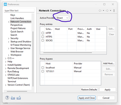

I had the same problem and solved it by changing Active Provider to Direct.

It took care the majority of the issue. Then I just need to change the Active Provider in Network Connections to "Direct" as other people mentioned here.

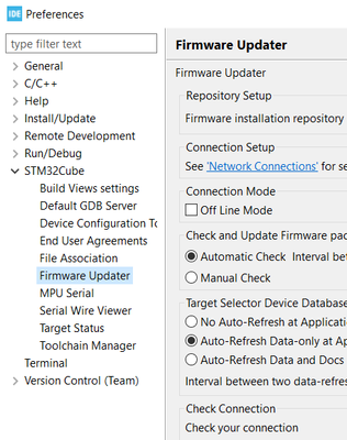

However, before our IT whitelisted the websites, I had been doing a way around it, which is changing the "Connection Mode" in "Preference->Firmware Updater" to "Off Line Mode" and downloading the firmware package needed from the ST website manually.

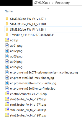

Yes, to do the "Off Line Mode", you just need to download the firmware from ST.com, unzip, and rename the unzipped folder to match their naming format. Then when you create a new STM32 project, the software should find it and start installing and create the project.
To download, go to https://www.st.com/en/embedded-software/stm32cube-mcu-mpu-packages/products.html Find the chip family of yours and download the version you need.
Save the firmware to here: C:\Users\<your username>\STM32Cube\Repository. You can find your exact firmware location in your STM32CubeIDE "Firmware Updater" too:
To unzip and rename: In the screenshot, you can see below are the zip files downloaded from ST. Above are the unzipped folders. Make the folder name like "STM32Cube_FW_<chip family>_V<version number>"

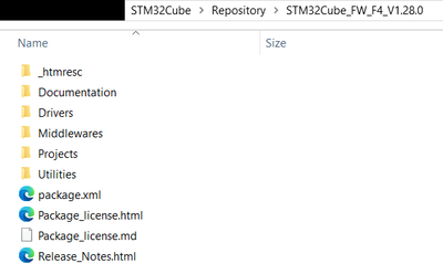

When unzip, make sure the folder structure is correct, like this:

Sometimes you may need to install some older versions in order to install the latest version. For example, when I tried to install F4_V1.28.1, I had to install V1.28.0 first, because V1.28.1 is a patch to V1.28.0.
Or the naming format maybe different in other chip family. If you have an older version already existed in the repository folder, you can use its naming format as a reference. For me, I had V1.27.1 already installed by the software a long time ago, so I know that format is what the software looks for and I changed the new firmware folder format to match that.

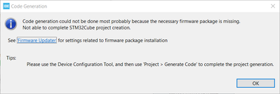

When it works, the STM32Cube software should start installing the firmware package when you create a new STM32 project. If you still see errors about code generation like picture below, that means something is still not setup correctly with your firmware folder, and the software doesn't recognize / couldn't find the offline firmware package you put there.

Thanks, Peter, setting it to Direct worked for me!
