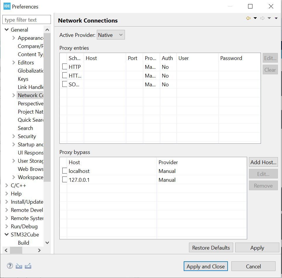

I had several versions of the IDE installed on my machine but none of them could connect to the internet to update or load code. I keep getting the error message "In order to benefit from best experience a network connection is required. Do you want to set connection parameter now?". At first I thought it was because Norton was blocking the the applications through the firewall but I uninstalled Norton and installed the IDE again but that didn't fix the problem. I installed the IDE on my brothers machine which doesn't have Norton and it worked fine on there. I also have used different networks in the past 2 months so that cant be it. Can anyone please help?

What are your settings in

What about the settings from the first point (Network Connections)?
You can also reach them by clicking Network Connections in the screen above.

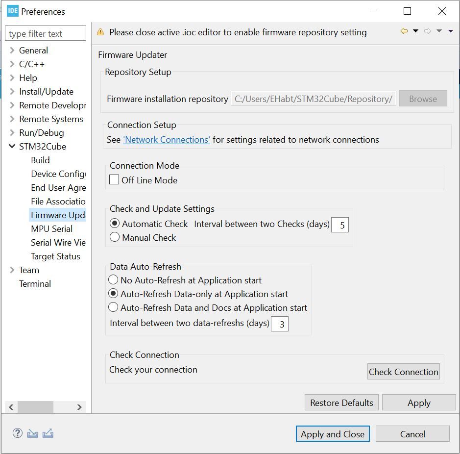

Setting the Active Provider to Native is usually fine.
If you are connected to the Internet without a proxy, you can test whether setting to Direct is working for you. Please Apply after setting and test the connection using Check Connection in Firmware Updater.
Instead set Active Provider to Manual and set the required parameters (host, port, user, pwd) if you are behind a proxy. It might also be a good idea to set these parameters and test Active Provider with Native again.
