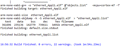

Here is a co-worker's build output, which is "good":

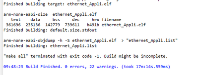

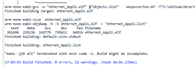

Here is MY build output that is "bad". I cannot get the "terminated with code -1" to go away:
2025-12-13 4:25 PM
Your build has not completed successfully, this is why debugging step won't start.
To understand why build fails, please remove temporary -j28 to run only one command at once. See which one fails.

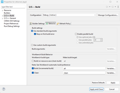

I disabled parallel build, but exit code -1 still occurs, see below. Any other ideas? I'm running STM32CubeIDE version 2.0.0. Perhaps I'll go back to 1.18 or 1.16

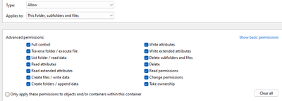

Very good ideas. I tried creating an IOC and project in my user directories, but it's still doing the same thing. Here's a screenshot of the permissions for my user directory:
I tried a few times in different subdirectories of my user directory. It's possible that it could be related to security protections on this PC.
