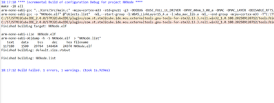

I did it this way; it gave an error in the first compilation, but it worked in the second compilation.
this is the first compilation

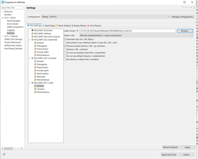

My settings are like this

first compilation
The first time I press the compile button, it gives an error.
Then, when I press it again, it doesn't give an error.
2025-12-18 7:27 AM
Your screenshot chops off the end of the line - so we can't see the full message.
Better to copy & paste it as text - see here for instructions.
