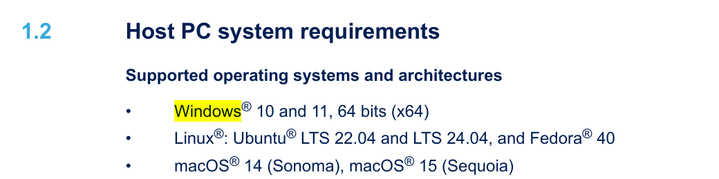

8.1 cant be updated ... is out of 1/2023 And you dont show IDE version ?

Version of IDE is 1.17.0
For more details you can check error files in attachment,
https://www.st.com/resource/en/release_note/rn0114-stm32cubeide-release-v1170-stmicroelectronics.pdf
if you require stay on 8.1 read this release and find IDE version with support 8.1

Do you know where I can find version 1.5.0 or can you propose some other IDE that is compatible with windows 8.1?
