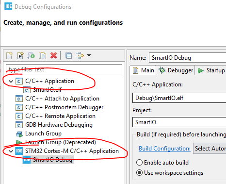

2020-02-25 8:14 AM
I have a project that I started and am currently debugging with STM32CubeIDE. Seemingly overnight it decided to start showing me that same error message whenever I clicked on the debug icon. For me the problem ended up being that I somehow had selected to debug as "C/C++ application" instead of "STM32 C/C++ Application". I couldn't quite figure out how to set up the "C/C++ application" configurations to work, but I'm back up and running again with the STM32 application that I had set up previously. That one seems to be ready to go with minimal to no changes on initial setup.

2021-04-08 8:52 AM
Error caused by ProjectName.launch file not created.
Make sure the project name is selected -> "debug as" -> STM32 Cortex-M C/C++ Application.

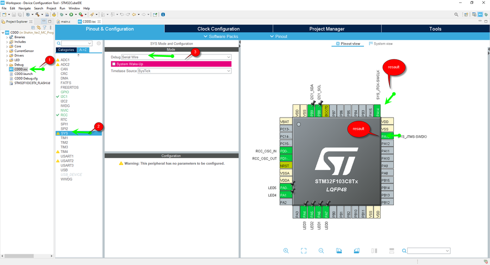

2021-09-05 12:13 AM
Hi. Please
1) check your programming type
2) regenerate cube MX in your project.
3) CTRL+S (for save)
4) start to test programming and debug
