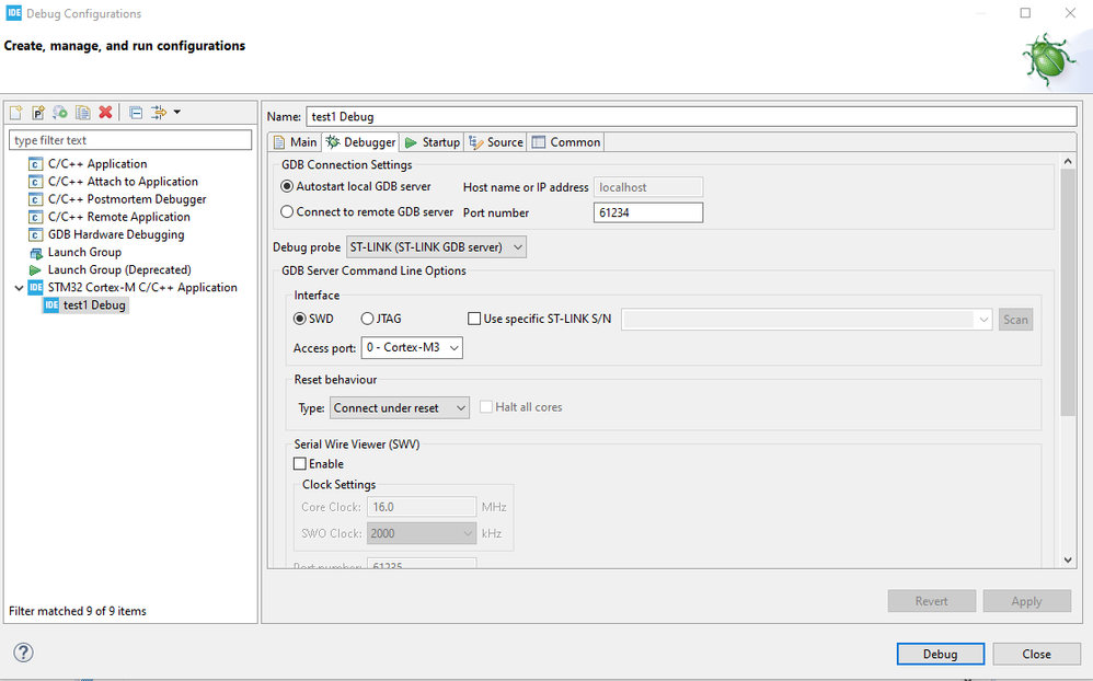

I'm sure it's something silly and I can't believe I'm the only person who has seen this message but searching this site doesn't yield any clues. Can someone point me to what I am setting up wrong, presumably in the Debug Configuration menu ?

I also ran into this issue after a couple days of everything working. This worked for me:
Select Project/Properties and select Run/Debug Settings. Delete all of the Launch configurations listed. Click Apply and Close.
The next time you try and debug, the Debug As dialog will pop up, select the STM32 Cortex-M C/C++ Application. That should fix it.

>"Looks like you don't have it pointed to the correct exe. In the "Debugger" tab give full path of the gdb.exe(Windows machine) of the cross compiler that you might have
> installed as the "GDB command"."
I have no idea, where to find this tab! All configurations I looked through, there was no path to be edited.
